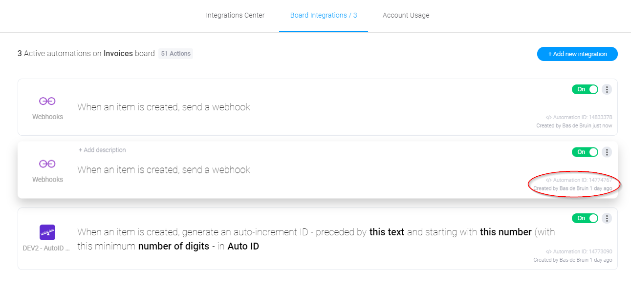

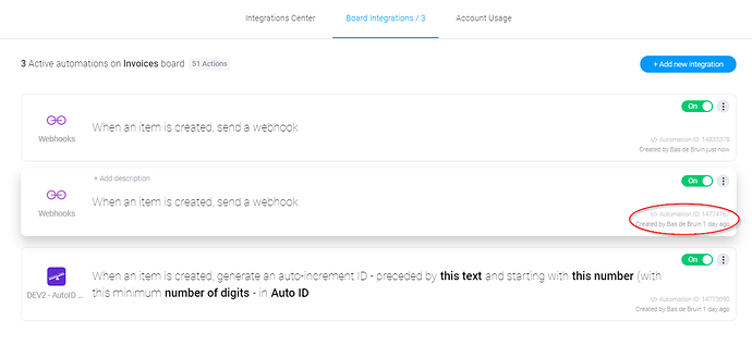

Sorry, I probably phrased it not very clear. I am talking about the visibility of the recipe containing the webhook (see below). When I change my recipe (the lowest one) that contains a custom trigger, I receive an unsubscribe and subscribe request. In the unsubscribe endpoint I delete the webhook with an API call delete_webhook. However this recipe is still showing up (the circled one) although not active. Looks like it is not browser cache, a refresh solves it.
For my users it is a little unclear what is going on
