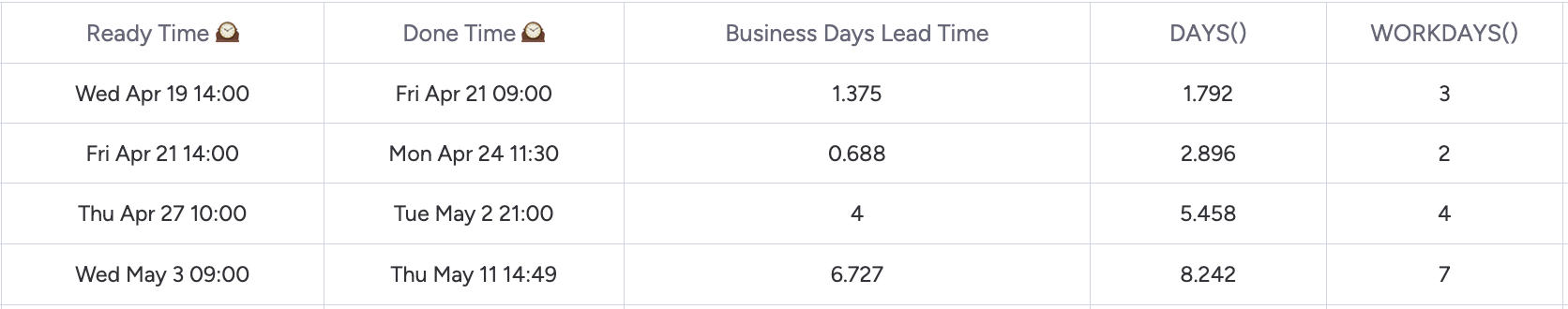

  1. WORKDAYS() is too imprecise by itself. If a task is started at 4pm on a Friday and finished at 10am on the following Monday, this gives a value of 2. A task started at 9am on a Monday and finished at 10pm the next day would give the same result. What we want is for the former to reflect how little actual business time there was between them.
  2. DAYS() gives us some information about the time, however it doesn’t account for working days. Additionally, it fails to capture the concept of working hours. If we start something at 10am and finish at 2pm, that will give us a result of 0.166666 days, which isn’t really helpful.

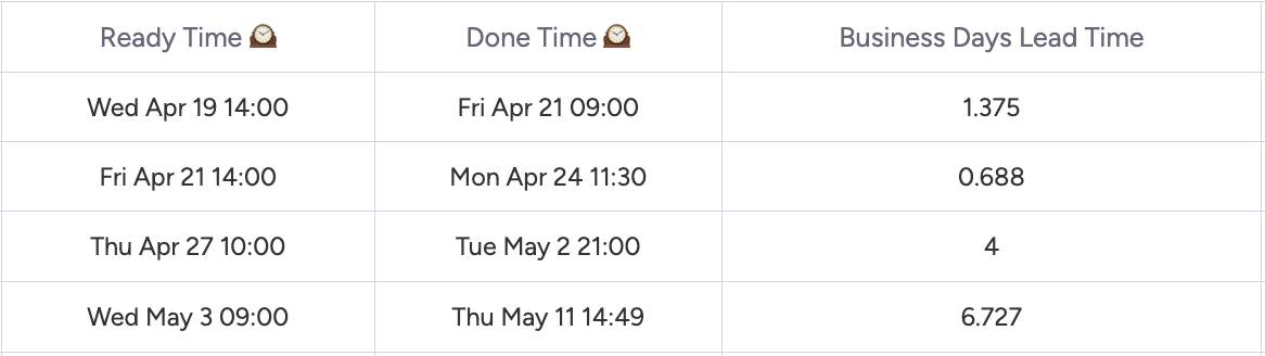

The formula then returns a number of working days, with the decimal representing a work day, rather than a full day. For instance, if we have a Ready Time of 2pm on Tuesday and a Done Time of 6pm on Thursday, we get a result of 2.5. This is an approximation of the “Business Days Lead Time”. i.e. it’s the number of working days it took for something to get done, accounting for hours.
Here are some example results (I used formula columns to show the days of the week here—my formula works with regular date columns that have times added).
Comparison with DAYS() and WORKDAYS()
